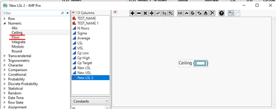

Hello
I have an option in Excel to round the number by significance number
for example, I have numbers as 13.24 or 0.57, and I would like to round it up or down to 0.05
Actually, I have found the option in FORMULA > NUMERIC
And I see the same function but I don't see the additional functions as by significance number
Can you assist to me how I can round the number by significance number 0.05
and receive the same result as I received in Excel?

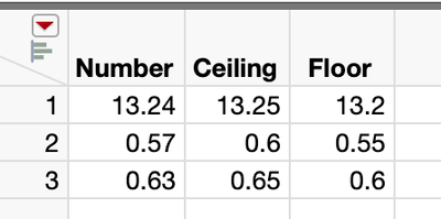

These formulas return the answers you are looking for.
I've attached the table here with those formulas.
