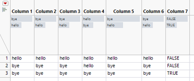

Many ways of doing this. Do you need formula, is setting values enough, JSL or not, interactive solution?
Here is one possible formula, but I would remove it after it has been calculated once, as it won't re-evaluate in similar manner as formulas usually do (this might not be a problem in this case thou).
If(N Items(Loc(Current Data Table()[Row(), 1::N Cols()], "hello")) > 0,
	"FALSE"
	"TRUE"
This script should give a little extra explanation, it won't create new column for you though. Open log and run this, you can also change Row() = 1 to Row() = 2 and so on, to see how it behaves on different rows
Names Default To Here(1);
dt = New Table("Untitled 9",
	Add Rows(3),
	New Column("Column 1", Character, "Nominal", Set Values({"hello", "bye", "bye"})),
	New Column("Column 2", Character, "Nominal", Set Values({"hello", "bye", "bye"})),
	New Column("Column 3", Character, "Nominal", Set Values({"hello", "bye", "bye"})),
	New Column("Column 4", Character, "Nominal", Set Values({"hello", "hello", "bye"})),
	New Column("Column 5", Character, "Nominal", Set Values({"hello", "bye", "bye"}), Set Display Width(75)),
	New Column("Column 6", Character, "Nominal", Set Values({"hello", "bye", "bye"}))
Row() = 1;
Show(Current Data Table()[Row(), 1::N Cols()]);
Show(Loc(Current Data Table()[Row(), 1::N Cols()], "hello"));
Show(N Items(Loc(Current Data Table()[Row(), 1::N Cols()], "hello")));
Show(N Items(Loc(Current Data Table()[Row(), 1::N Cols()], "hello")) > 0);
Edit:
Removed extra "," from the formula
-Jarmo

In terms of excel, this is my formula:
=IF(COUNTIF(R21602:AC21602,"HELLO")>0,"FALSE","TRUE")
jthi
Re: Return "True" or "False" if multiple columns contain string
 You would create new formula character column Create Formulas in JMP (jmp.com) as last column in the data table and copy paste the formula I provided. After that you could re-open the column properties by double clicking the column header and remove formula if you want to. If you have JMP16 enhanced log should give you script to perform this if it is needed.
I had one extra "," in the earlier post (I will edit it out):
	"FALSE"
	"TRUE"
-Jarmo

Hi,
I tried out the formula, but its only blank. Is there a way to do it as like excel =IF(COUNTIF(R21602:AC21602,"HELLO")>0,"FALSE","TRUE"), where we can only target specific range of columns to check for "Hello"?
Formula:
dt << New Column("Scan_RESULT", Character, Nominal Formula(If(N Items(Loc(dt[Row(), 1::N Cols()], "hello")) > 0)),
"FALSE"
"TRUE"
