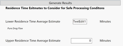

The second module is intended to be the output module. With the push of a button, I would like this module to display the newly calculated column values as a result of the use of the first module. In this second module I have several boxes (either number edit, or text edit, I'm not sure which is correct to use for this purpose) that are laid out in a user friendly way to display calculated values.
I am struggling to get the boxes to display the column values. I have attempted the following ways and I have tried to set it up similar to the way the input module works, but no success. Currently the text edit method is the one I have active.

Ideally, the boxes in the following picture will populate with values from the table.
