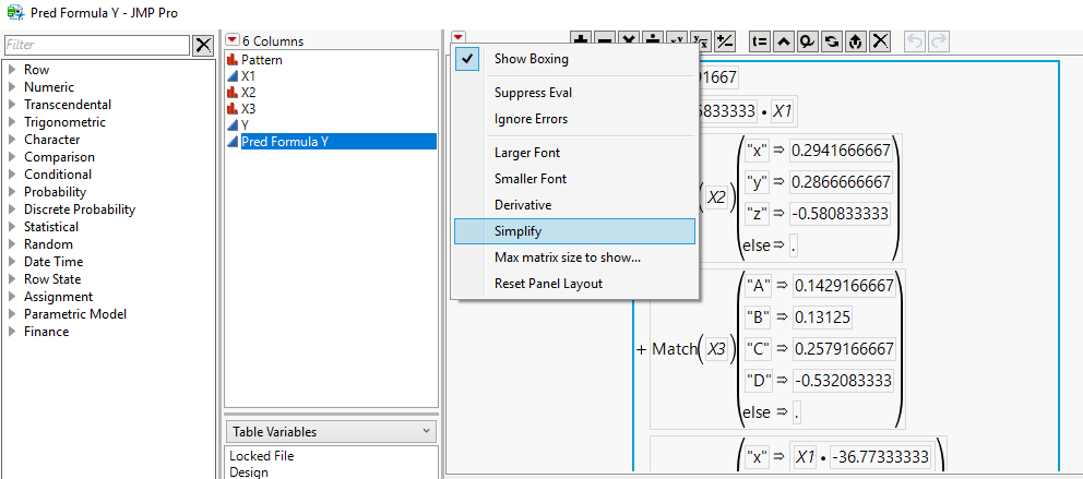

Hello, I'm quite new to the JMP script but I'm trying to get the coefficients of the prediction formula from fitted models.
There are already many posts describing how to obtain the prediction formula in scripts, but what I want is the formula after applying "Simplify" in the JMP interface.
Save Columns==>Prediction Formula==>Open up the formula from the data table==>From the red triangle pop up menu of the equation editor, choose simplify

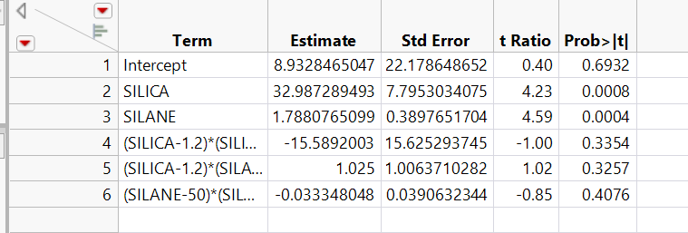

My ideal picture is to obtain the simplified formula coefficients in a new data table, similar to right click in "Parameter Estimates" ==> "Make into (combined) Data Table"
I have the code for constructing the fitted model, but I don't know how to include the simplified function and save it back to a new table.

And you can script the Make Into datatable from Fit model:
dt_new = ((obj << report)["Parameter Estimates"])[TableBox(1)]<< Make Into Data Table;

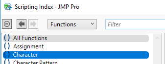

Check Scripting Index for great source of JSL scripting.

And from there start parsing it into lists. For parsing following functions might get you started: Words(), Substitute() (and Regex if you know how to use it). More functions can be found from Scripting Index:

But I want to create a new table which shows the coefficients and the variables from the simplified formula like the "Make Into Data Table".
If using the original Make Into Data Table function, it creates a table contains the coefficients from the "non-simplified" ones.
As now the simplified_formula has been saved, is there a way to transform it to a table (not the prediction value, just the coefficients and variables)?
