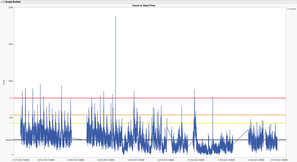

I was wondering if there would be an easy way to retrieve the average amount of time (in hours or minutes) that a signal stays above a certain limit within time series data. I have added an example data set in the attachment.
I added some preliminary SD limits which i calculated based on the mean baseline of the data.
So what would be the avarge amount of time for the signal to return back below 2SD, 3SD or 5SD?

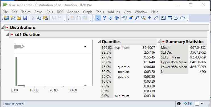

It is a pretty simple formula that will calculate the durations.
And then I just ran a distribution to see the shape of the data, and to get the mean.
In my example below, I only create one new column that determines the duration time spent over 1 SD.  The formula is pretty straight forward so using it to calculate the 2SD etc. should be expandable from the first formula.
Here is the JSL to do the calculation and display.  This can easily be done interactively.
