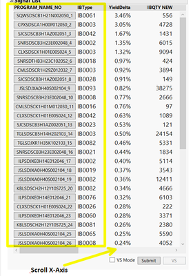

I want to freeze below columns "PROGRAM_NAME_NO" and "IBType" while scrolling X-Axis of TableBox?
Is there anyone who knows how to solve this issue? Do appreciate your favor.

Those seem to be the first two columns in the table box. Maybe following will work:
TableBoxReference << Set Locked Columns(2);

Hi jthi,
Thanks for your answer. I have tried this solution, it does not work for me. Literally, I post my question on JMP community.
Do you have any other solutions?  Thanks :)

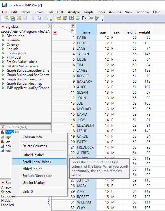

To do this interactively, go to the columns panel and right click on the column you want to freeze, and select  Scroll Lock/Unlock

Hi txnelson,
Appreciate your answer. I've tried this solution before, it only works when you scroll the DataTable but not work while scrolling the TableBox on the window.
So I post my question here for other solutions. Looking forward to your reply!
