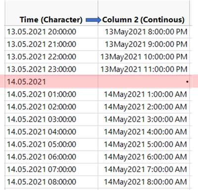

Convert time from character to continous
I have a "Time" column in my dataset and am attempting to convert it to Continuous data type. I am using the "Set Format Pattern" in JMP 16 and everything looks OK except for the timestamps at midnight. This is because the midnight time (00:00:00) in the original dataset is missing. See the attached picture. Any suggestions on how to fix it?

@shasheminassab
I would just pass through the Time(Character) column and add " 00:00:00" if the hours, minutes, seconds do not appear
Something like this should work
Names Default To Here( 1 );
dt = Current Data Table();
For Each Row(
	If( Contains( :"Time(Character)"n, ":" ) == 0,
		:"Time(Character)"n = :"Time(Character)"n || " 00:00:00"

Re: Convert time from character to continous
I would most likely start by fixing the wrong data. If there are only couple of wrong values you could use recode or you could write some formula to do the fixing for you. Below is one option that could work:
Names Default To Here(1);
dt = New Table("Untitled 3",
	Add Rows(5),
	Compress File When Saved(1),
	New Column("datechar",
		Character,
		"None",
		Set Values(
			{"13.05.2021 20:00:00", "13.05.2021 21:00:00", "13.05.2021 22:00:00",
			"13.05.2021 23:00:00", "14.05.2021", "14.05.2021 01:00:00"}
wait(1);
Column(dt, "datechar") << Set Each Value(If(Length(:datechar) <= Length("14.05.2021"),
	:datechar || " 00:00:00", :datechar));
-Jarmo

shasheminassab
Level IV
Thanks Jim. Very helpful as always.
