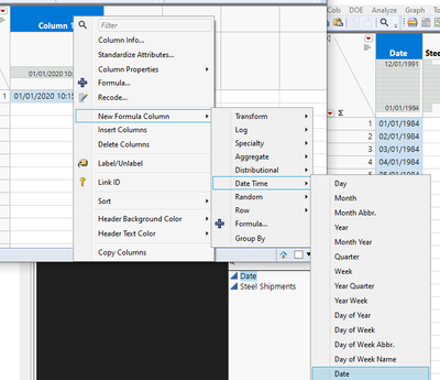

I would create new column which removes minutes and seconds from your date time column. You can create it with quick formulas JMP provides you with but it will require few of them. First you can create Date column

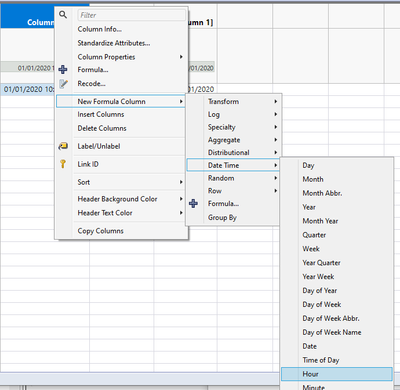

Then create Hour column

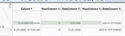

And combine these
Next open the created column, change format and modify the formula by multiplying the hour by In Hours(1) (same as 60*60 which is seconds in hours, this is basically how JMP manages time). Final formula would look something like this
In Hours(:"Hour[Column 1]"n) + :"Date[Column 1]"n

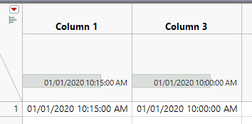

Are your data evenly spaced, i.e. one minute average or snapshot, or have timestamps that could be from any time within the hour? Do you want to aggregate the data to an hourly average or just round the timestamps to the nearest hour?
In either case, the easiest way is to: rightclick on the timestamp column > New Formula Column > Transform > Round > Nearest 1 hour
Once you've created the rounded timestamp, to create the hourly average: Tables > Summary > Group: Rounded Timestamp; add the data columns with the statistics you want <Table Summary>

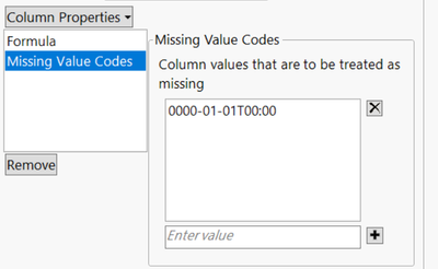

As a workaround, one can exclude the wrong rows,
change the formula to
tmp = Date Increment( :"date-time"n, "Hour", 0 );
If( tmp == -60084288000,.,tmp); // "0" = -60084288000
... or use -60084288000 as Missing Value Code via the column properties:
