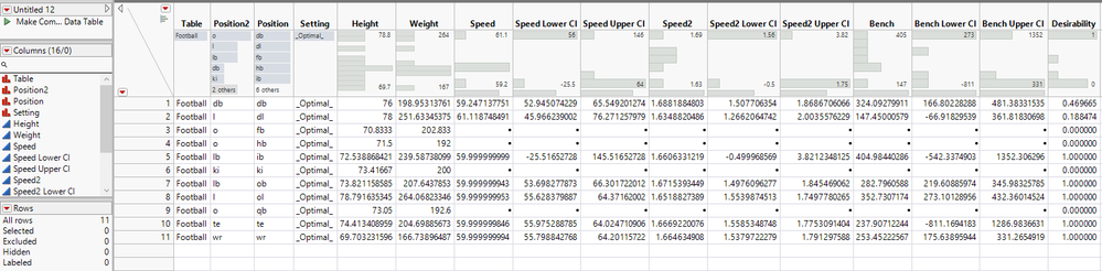

//create a data table with the parameters from the prediction profile
//in my other version (with the for loop a Where( :x = y[i]) in the model, I than had some code to concatenate tables together and change some formatting
dtout[1] = (rfit["Prediction Profiler"]["Remembered Settings"][Table Box(1)] << make into data table);

pf_obs = fit << XPath("//OutlineBox[text()='Prediction Profiler']"); // list of lists so easiest to loop over them
For Each({pf_ob}, pf_obs,
	pf = pf_ob << Get Scriptable Object;
	pf << Maximize and Remember;
dtout[1] = Report(fit[1])["Prediction Profiler"]["Remembered Settings"][Table Box(1)] << Make Combined Data Table
