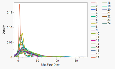

So I guess this gets to the heart of what I am wanting to do. I think I can compare samples means and variances once I've confirmed we've sampled correctly. But as you said, I need to do the within and between image analysis. However, I'm not sure how to do that. For example, here is a compare densities plot of 24 processed images from one of my samples.
As can be seen, while they all have something of the same shape, the parameters for whatever distribution model would fit all of those density curves is are going to be very different between images, because the zoomed in images disproportionately sample small particles, and the zoomed out ones disproportionately sample large particles. However..... That may be fine. We certainly need to sample all of the particle size classes, and only the most ideally dispersed sample would have the same distribution on every image. But how do I know I've correctly sampled all of them correctly? Is there a statistical test for that that involves/is weighted by sample size? Do I need to learn about bootstrapping methods to just wipe the sampling issue under the rug? These are really the points of my confusion.
