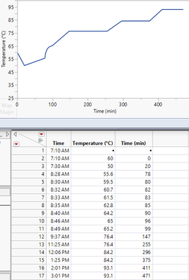

However, I am getting a blank/missing item in the first cell of the Formula Column, which then causes my resulting graph to not start at zero.
Right now, I'm getting around it by inserting a row at the top of the data table with the same time, which results in Row 2 providing a zero-point.
Is there a way to treat the missing value as zero in a locked column? Or better yet, is there an edit I can make to the formula to form a T0 point?

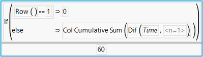

You can for example add if statement
If(Row() == 1,
	0
	Col Cumulative Sum(Dif(:Time))

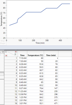

Beautiful, thank you! The below worked perfectly.
