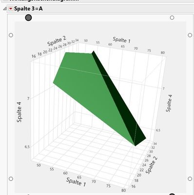

I also created plots for the dependency of the response variable with respect to every factor. They are looking like those automatically produced in OriginLab and I produced a "Wirkungsflächendiagramm". -  a surface plot -
and I got this result with JMP

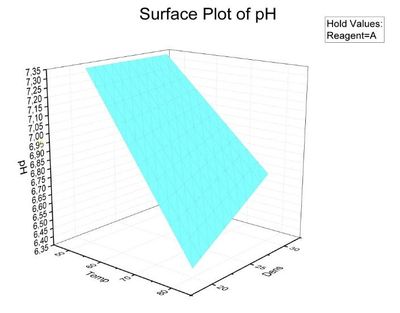

However, with OriginLab I got this surface plot:
 Compare the pictures: although axis parameters are the same, the surfaces do not appear to be the same.
