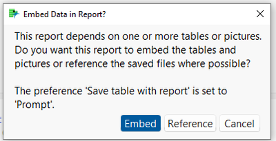

Hi,
the script below generates a window with an image, a script box and a play button.
When I click on play, I get the warning:
I don’t want to save any report – I just want to run the script – without a warning message.
I can disable this message on my computer via the preferences, but another user might want to have this choice.
how can I disable the warning message for my report?
When I click on "Reference", in the future, I can run the script in the Scriptbox without the warning - till I close the window and open a new report. Can I somehow set it once to “Reference” for the report, such that the warning doesn’t show up?

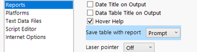

When I run the script (windows 10 using JMP Pro 18.01) and press Play I do not get the same prompt. The caption box opens normally and I can close scripts/window like I normally would. My preference for Save table with report has been set as Prompt
-Jarmo
hogi
Level XIII
Re: Report with an image
Hm, surprising.
I see it with Jmp17.2, 18.1 and JMP 19EA4.

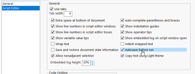

Interesting, seems that JMP just clicks on  save - even if the window is a report window !
NB: the autosave before run is very (!!) helpful.
I don't know how many times it saved the work of the last 30min  from a nasty bug in the script!
