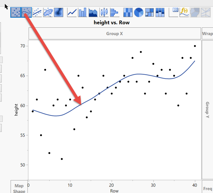

How to find this regression line by adding new columns to the table?
Thanks!
dt=Open("$SAMPLE_DATA/Big Class.jmp");
Graph Builder(
	Variables( X( Transform Column( "Row", Formula( Row() ) ) ), Y( :height ) ),
	Elements( Points( X, Y, Legend( 3 ) ), Smoother( X, Y, Legend( 4 ) ) )

Re: How to find this regression line by adding new columns to the table?
I tried, it needs to be saved like this when there is a drawing.
How can this column of data be calculated directly in the form of a formula without drawing a picture?
Thanks Experts!

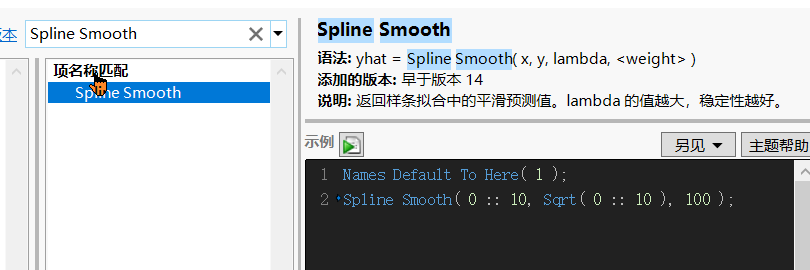

Maybe one of the spline related matrix functions would work?
-Jarmo
lala
Level IX
Thank jthi !
I don't know how to search for documents
