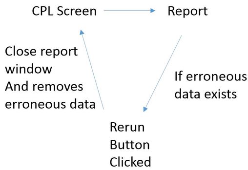

It seems that the original report doesn't close prior to the new one opening.  I am stumped considering I can phyically run the same code and everything works.  The following is a suedo flow chart of what the script is doing:
Any help would be much appreciated
