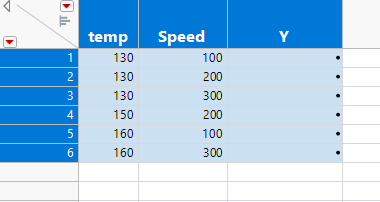

Hi ,
 I had a custom design with 6 runs for having a model  to predict the effect of temp and speed on performance . I had 5 samples each from each run. But after having the results I understood that there is lot of variance within the performance of each sample. Iwant to  account include this variance in my model. I replicated each run 5 times and made a design of 30 runs. So I treated each samples performance as one run. So i believe this design would help to account for the variance within the runs.
Is this a right method? Can someone suggest alternative methods to account for those variance within the predictive model?
@Phil_Kay  Coud you please take a look at this problem? Please let me know if you need more clarification in the question.
Thanks
Jerry

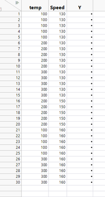

I agree with @Victor_G . It is important to know if these are 30 independent runs of the process. Or if there were 6 independent runs of the process with 5 measures of the outcome from each run.
E.g. how did you carry out run 2 in the table above? Did you run the process again? Or did you just re-measure the response on the outcome of run 1?
Also, if they are 30 independent runs of the process, did you carry them out in the order above? Or did you randomize so that you were changing process factors between each of the 30 runs of the experiment?
If you can let us know more about how the 30 measures from the experiment were made, then we can advise on the appropriate analysis.
Thanks,.
Phil
Victor_G
Re: Replicated runs for accounting the variance
You're right @Phil_Kay, I didn't look at the run order, but the order is very important too, as it could also mean there were some randomization restrictions, implying here that factors "temp" and "Speed" would be "Hard-to-change" factors in the experimental setup.
@Mathej01 More info on the assumed model would be helpful, as well as a the datatable used for design generation, as I'm not sure about some of the levels used in the design (Speed level at 150 ?), as well as the repartition of the levels (particularly for "Speed" factor which is not completely balanced between high and low levels). If this design was intended with 2 hard-to-changes factors, the number of whole plots (or runs) may not be sufficient enough if you're interested in quadratic effects for both factors (as possibly intended with the presence of middle levels ?).
For illustration, please find attached a Custom Design with 2 hard-to-changes factors "temp" and "Speed", with 8 blocks and 30 runs, which may do a better job than the current design (if factors are hard to change and model terms include interaction and quadratic effects), available through the script "Original datatable".
Waiting for some feedback and inputs from you,
Victor GUILLER

HI @Victor_G @Phil_Kay ,
Thank you so much for your replies. I think my problem needs more explanation :).
@Victor_G  Regarding the design, maximum feasible runs were 6 , and I wanted to have 150 degc and speed 200. So i treated them as discrete numeric when making the design. I assume that is fine? But i agree that the design is not very efficient.
Regarding the question of whether it's a repetition or replication, I will explain how my experiment was conducted and how the measurements were taken.
It was a coating experiment where a product was coated at different application temperatures and speeds. Only six runs were conducted, and I obtained several meters of coated samples from each run. From each of these samples, I cut out five samples and tested them for their performance under same conditions, denoted as "Y".
However, there was significant variations in the value of Y from sample to sample.This was due to unfavorable combinations of speed and temperature and which resulted in  uneven dots on the coating. But i want my model to account for these variations.
According to your explanation, I believe this cannot be treated as a replication of the run?
Please correct me if I am wrong.  If there is any possibility to account for these variations within my model, Please let me know.
thanks in advance
Jerry

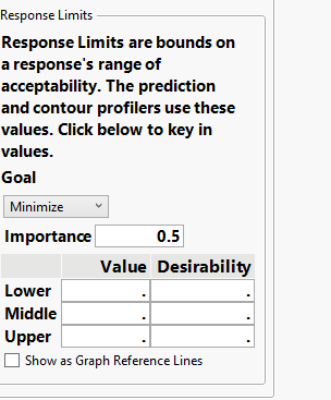

Mathej01
Level III
Thank you so much @Victor_G ,
I choose the first option that you gave. I use both mean and standard deviation as responses.
(1) But in the prediction profiler. I am still confuse how much weightage should i give for the mean value and standard deviation. Any insight on this?
(2) And i understand the model will consider the weightage by the "importance" we give when we set the desirability. Is there a right method to choose the importance when we set the desirabilities. (figure below)
Thanks in advance
Jerry
Victor_G
Hi Jerry,
You're right about the importance values, this will enable to find a trade-off between several responses, in your case between mean and standard deviation responses.
There is no rule about this tradeoff and values settings, it depends how much emphasis you want to put on the robustness of your optimum. You can try different importance values, and see if your found optimum has a standard deviation in accordance with your specifications for example : check that the optimum - 2/3 std dev is still an acceptable value for you, or try to find an higher optimum and/or lower standard deviation value.
Please note that importance can have an impact on the finding of an optimum, but also the slope of the desirability curves : the steeper the desirability curve of a response, the more influence this response will have on the finding of the optimum, as any deviation on the factors will have greater change in desirability values than for other possible responses.
I hope this complementary answer will help you,
Victor GUILLER
