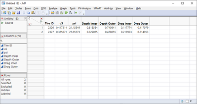

txnelson
Re: Reorganizing A Table by Items Within A Column

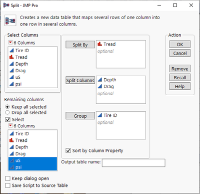

What you are asking for is available by using the Split platform
     Tables=>Split
After you open the Split platform, setup the screen as shown below
Once you click OK, it will create a new data table

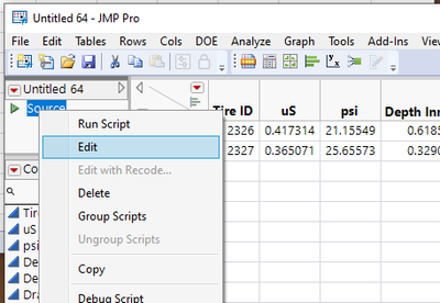

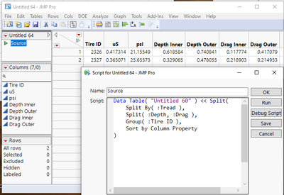

The script to perform the Split is contained in the Source entry of the data table
Just right click on the word Source
and select Edit
The Edit window will open and show the JSL required to run the Split and create the data table you want.
Just cut and paste the JSL from the Edit window, into your script

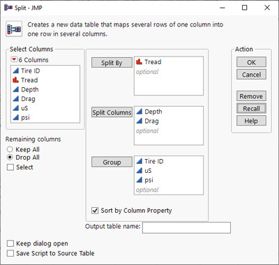

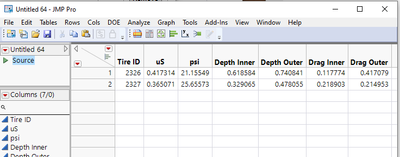

pmroz
Nice Jim!  Much better than my brute force approach.  I would add uS and psi to the Group columns as per @Arocha1 's request.
