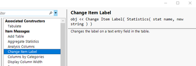

Concerning your attempt to change the display name of "Identity" to "Phase", once again the Scripting Index provides the reason your JSL does not work.

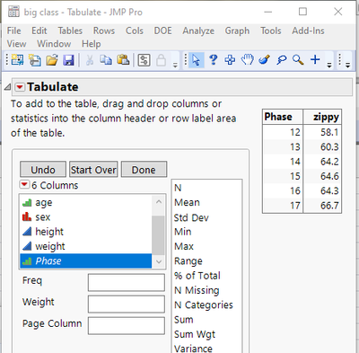

The Change Item Label only has the current capability of changing the Statistics label.  A workaround for this is pretty simple.  One can add a new Virtual Transformation column to the Tabulate Dialog Box.  Declare it a Formula and then set the formula for the new column to be
:Identity
Then rename the new Transform column "Phase" and use it in the definition of your Tablulate table, as I have done in the simple example below
In this case, I used the column Age as you would use Identity
Here is the JSL that my simple example creates
Tabulate(
	Change Item Label( Statistics( Mean, "zippy" ) ),
	Remove Column Label( Analysis Columns( height ) ),
	Show Control Panel( 0 ),
	Add Table(
		Column Table( Analysis Columns( :height ), Statistics( Mean ) ),
		Row Table(
			Grouping Columns(
				Transform Column( "Phase", Ordinal, Formula( :age ) )
