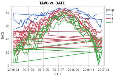

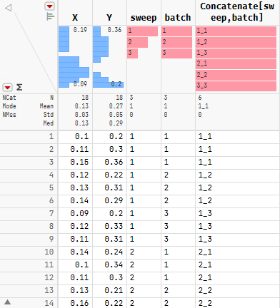

I have 4 variables - let's call them X, Y, sweep and batch.
X and Y are numerical continuous, sweep and batch are numeric nominal.
I want to plot XY line curves, per sweep and batch.
The data looks like:
X       Y       sweep      batch
0.10    0.20      1               1
0.11    0.30      1               1
0.15    0.36      1               1
0.12    0.22      1               2
0.13    0.31      1               2
0.14    0.29      1               2
0.09    0.2      1               3
0.12    0.33      1               3
0.11    0.31      1               3
0.14    0.24      2              1
0.10    0.34      2              1
0.11    0.30      2              1
0.13    0.21      2              2
0.16    0.22      2              2
0.18    0.33      2              2
0.12    0.21      3              3
0.17    0.27      3              3
0.19    0.29      3              3

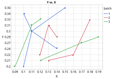

I use the overlay for sweep and color for batch.
The graph puts a line between my last point of a (sweep,batch) to the 1st point of the next (sweep,batch).
I think in jmp17, this was resolved by clicking 'Row order' but no luck with jmp18.
Can someone help, please?

This is the plot I get, which connection is incorrect?
-Jarmo

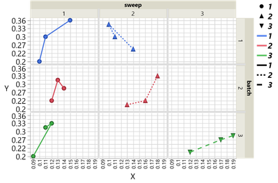

I think this was the intention:

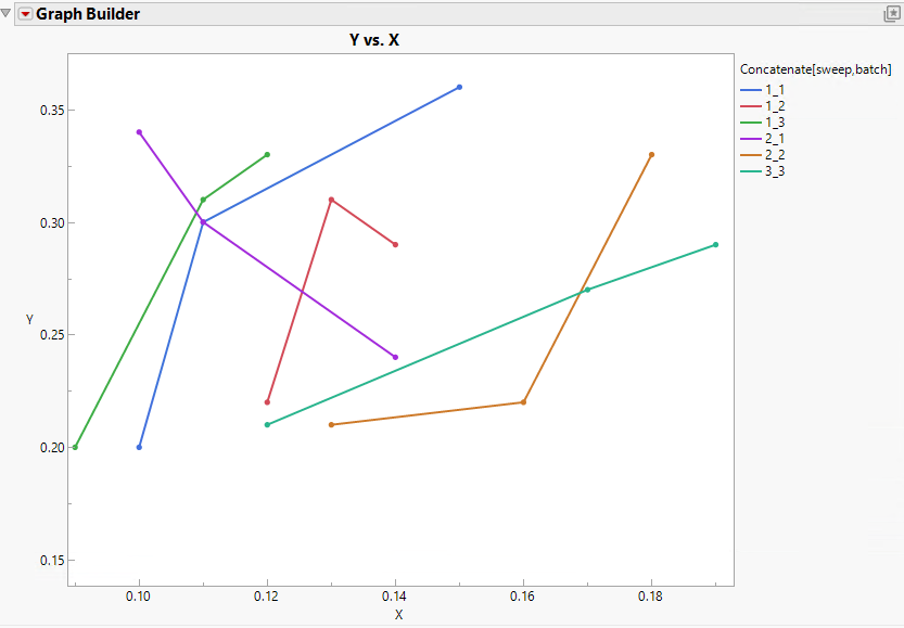

Then indeed, @miguello 's approach is the key - just activate row order() to get the lines right:
Graph Builder(
	Transform Column( "Concatenate[sweep,batch]", Character, Formula( Char(:sweep) || "_" || Char( :batch ) ) ),
	Variables(
		X( :X ),
		Y( :Y ),
		Overlay( :"Concatenate[sweep,batch]"n, Overlay Encoding( "None" ) ),
		Color( :batch )
	Elements( Points( X, Y ), Line( X, Y, Ordering( "Row Order" ) ) )

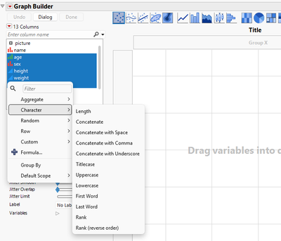

Good news: you don't have to add any column to the data table.
In the report, select 100 columns - right click - concatenate. That's it.

hogi
Level XIII
Re: Remove line between last point of a curve and 1st point of next curve
report -> plot window.
select the columns, right click:

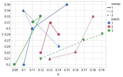

Claire
Level II
Thanks miguello for your help - you are correct - your plot is close to what I wanted (but I wanted sweeps in solid/dots/dashed and batches in different colors to differentiate the type of variables) I'll reply to the latest comment - to you / jthi and hogi
