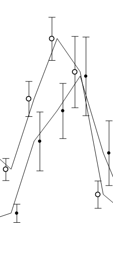

However, when I overlay multiple groups of data, the "bars" (the error bars) automatically jitter for every x-value so that they don't sit on top of each other:
You can see that because of the jitter, the line no longer goes through the point in the error bar. More importantly, because this is longitudinal data, the jitter gives the impression that the x-values for the overlaid data are different, when in fact they are the same.

There is an easier option - even without the jitter-problem when you use an additional overlay variable. First create a column for lower and the upper value each (as descripted above). Then stack the data (central point, upper value, lower value). Open graph-builder and add the stacked data to the y-axis. Then choose summary statistic "mean" and Error bars "range". That's it. Even without the jitter problem! Good luck :)

I tried this solution and it worked. Thank you!
