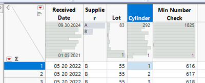

Hello,
I've tried to use this video linked below to use the SQLQuery function. However, I'm having an issue.
community.jmp.com/t5/video/gallerypage/video-id/tvcW9lZTE6Ie3IFXxeru0AYNqvj5AB5r
Problem: Take Table 2 with "cylinder" "Received_Date" and "lot" & merge that into Table 1 that has "batch", "cylinder" and "Batch_Date"
I need to match exactly on "Cylinder" and then take the nearest backward "Received Date" to the "Batch Date" (Batch_Date >= Received_Date).
I created the query & also did the step to create a numeric tag that should theoretically provide only 1 unique lot number for each batch (not shown in table below)
However, this is what I'm getting
BatchBatch DateCylinder NumberLot NumberReceived Date
12/13/2023 55A6/14/2022
12/13/2023 55B10/21/2022
12/13/2023 55C11/30/2022
There should only be 1 row populated from the query (should be the last row 11/30/2022); the other ones are "ghosts" as we only made 1 "Batch 1"
Any help on how to improve the SQL code to prevent duplicate entries & pick the entry only if the received date is the closest <= batch date?

jthi
Re: Remove Duplicate Entries from SQLQuery Based on Date
This is quite close to the limit on what I would attempt to do with JMP's limited SQL capabilities (at least when using data tables). It is most likely simpler to use SQL + JSL
Names Default To Here(1);
res = New SQL Query(
	Version(130),
	Connection("JMP"),
	JMP Tables(
		["t1" => "$DOWNLOADS\Table1-1.jmp",
		"t2" => "$DOWNLOADS\Table 2-2.jmp"]
	QueryName("SQLQuery2"),
	CustomSQL(
		"\[SELECT
			t1.Cylinder,
			t1.Batch,
			t1."Batch Date",
			t2."Received Date",
			t2.Supplier,
			t2.Lot
		FROM t1
			LEFT OUTER JOIN t2 ON
				t1.Cylinder = t2.Cylinder
				AND t1."Batch Date" >= t2."Received Date"
) << Run;
res << select where(Row() == Col Max(Row(), :Cylinder, :Batch) | Is Missing(:Lot));
res << Invert Row Selection;
res << delete rows;
-Jarmo

Hello - thank you for the quick help! I tried the macro & unfortunately for some items it is keeping the oldest possible date. It doesn't appear to be doing this for all entries though ( see last row of the table below).
So this is a definite improvement that there aren't multiple rows for the same batch, but it's not consistently pulling the right lot/received date for that batch in question.

jthi
I'm not really sure how to read your table. If I take a look at Table 2-2 there is only 1 row for Cylinder 1 which has Received date 05/20/2022
-Jarmo

Polygon0516
Level II
Thank you for this assistance! I realized there was an error within my original data set (I modified it for entry on this website to anonymize the data). This code has been working well, will reach out with any other questions.
