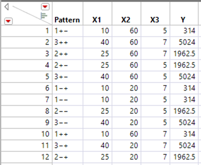

I created a 2^3 full factorial experiment with 4 center points. X1, X2 and X3  are the factors and Y is the response. X2 and X3 are just any random factor, but X1 is the radius and Y is the area. So mathematically relation is Y=3.14*X1^2

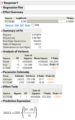

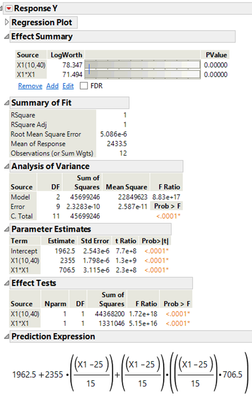

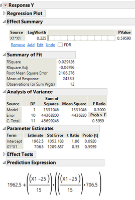

Below are the three scenarios where I computed regression equation based on just X1, both X1 and X1^2 and only X1^2.
When I only consider X1^2, it is no more significant. On further researching I came across Effect Heredity which states that we should have lower order effect included when we have higher order effect in our regression model. But than we will never be ale to find a relation that is pure quadratic as in this case.

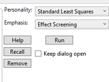

I have also mentioned the model details that I used to analyze the data. Does different setting give me a better answer.

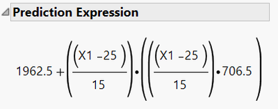

Actually, the regression coefficients are correct. You are not able to see it because of the default factor coding that JMP uses when analyzing a designed experiment.
You see this prediction expression:

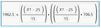

Notice that we should not expect the slope parameter to be 3.14 because that is not what is multiplying X^2. Instead, the 706.5 is multiplying ((x1-25)/15)*((x1-25)/15)).

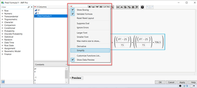

If you save that prediction formula from the red triangle and open up that formula from the data table, you will see this:
Now from the red triangle at the top (highlighted here), choose Simplify:
You will see the modified equation with the 3.14 that you expected.
The 3925-157*X1 appears because the model that I simplified only had the quadratic term in it. That leads to these "extra terms" that should not be part of what we know as the true model.
Now if we had fit the model following hierarchy (as recommended) and simplified this equation:
we will get exactly what you want (subject to round-off error)!

In the previous example that I have shared, the linear factor by itself gave me R^2 adj of 0.967, and including the quadratic term bumped it up to 1. If this relation was not know why should someone include the quadratic term?

Thank you, Dan:
That was a great explanation.
