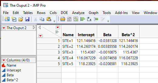

Rather than forcing JMP to create a data table from the display output, I have found that many times it is easier to go directly to the table of interest and extract the individual values.  This technique can be used to either generate all of the output with a By clause and then going through the display, or by generating one display at a time, extracting what you want, saving it to a table or a list or a matrix, and then closing the output and moving on the the next regression.
Names Default To Here( 1 );
dt = Open( "$SAMPLE_DATA/semiconductor capability.jmp" );
biv = dt << Bivariate(
	invisible,
	Y( :NPN1 ),
	X( :PNP1 ),
	Fit Special( Degree( 2 ), Centered Polynomial( 0 ), {Line Color( "Medium Dark Red" )} ),
	by( :site ) // Where( :SITE == 1 )
dtOut = New Table( "The Ouput",
	New Column( "Name", character ),
	New Column( "Intercept" ),
	New Column( "Beta" ),
	New Column( "Beta^2" )
dtOut << add rows( N Items( biv ) );
For( i = 1, i <= N Items( biv ), i++,
	dtOut:Name[i] = Word( -1, Report( biv[i] )[Outline Box( 1 )] << get title, " " );
	values = (Report( biv[i] )["Parameter Estimates"][Number Col Box( 1 )]) << get;
	dtOut:Intercept[i] = values[1];
	dtOut:Beta[i] = values[2];
	dtOut:Name( "Beta^2" )[i] = values[1];
biv << close window;
