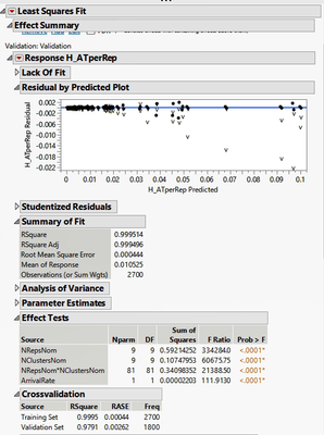

I am fitting a model to my response (dependent variable - DV), which is continuous, using 3 independent variables (IV) [2 categorical and 1 continuous] and the interaction between 2 of them (the other one I am just using the main effect). I first used Least Squares for that, as you can see in the screenshot below.
However, my residual by predicted plot does not look very good (I have some outliers). No matter which other factors I tried to add to the model - or transformation - I was not able to improve my residuals plot. The best I could get was using a change of my response, which is the one I am already showing above.

Also, according to JMP help (https://www.jmp.com/support/help/en/15.2/index.shtml#page/jmp/training-and-validation-measures-of-fi...) the Generalized RSquare provided should be between 0 and 1 and it will simplify to the traditional RSquare for continuous normal responses in the standard least-squares setting. However, as you can see from the screenshot below, although the Generalized RSquare matches the RSquare for the Training set, it does not match for the Validation set (and it is negative). The other statistics (e.g. RASE) do match both sets (Training and Validation).

I noticed in your original residual plot that the outliers all seem to be in the validation hold-out set.

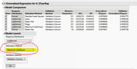

Finally, would you mind pointing me to the JMP help page that indicates the Generalized Regression uses MLE instead of OLS when the distribution is normal?
Because of the image below (taken from JMP), I was under the wrong impression that the Generalized Regression would still use OLS if the distribution chosen was Normal:
