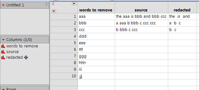

The for loop needs to start at 1.  the regex function needs to work with a JSL variable, it can't use the column.  You might want to use a table variable to hold the list of words to delete rather than keeping them in a column.  the JSL could be a lot simpler...see second example.
example 1
New Table( "Untitled 1",  Add Rows( 10 ), New Column( "words to remove", Character, "Nominal",
      Set Values(
        {"aaa", "bbb", "ccc", "ddd", "eee", "fff", "ggg", "hhh", "iii", "jjj"}
  New Column( "source", Character, "Nominal",
      Set Values(
        {"the aaa is bbb and bbb ccc", "a aaa b bbb c ccc ccc", "b bbb c ccc", "",
  New Column( "redacted", Character, "Nominal",
      Formula(
        x = :source;
        For( i = 1, i <= 10, i++,
            x = Regex( x, :words to remove, "", GLOBALREPLACE ),
        x;

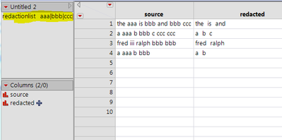

New Table( "Untitled 2",  Add Rows( 10 ),
  New Table Variable( "redactionlist", "aaa|bbb|ccc|ddd|eee|fff|ggg|hhh|iii|jjj" ),
      Set Values(
        "fred iii ralph bbb bbb", "a aaa b bbb", "", "", "", "", "", ""}
      Formula( Regex( :source, :redactionlist, "", GLOBALREPLACE ) )
