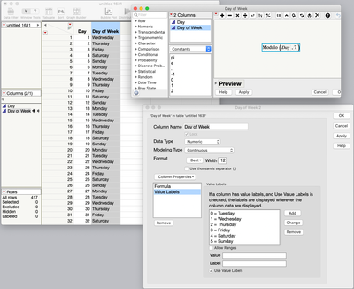

Building on @txnelson's solution, you can use a Formula column with the Modulo() function that he showed, along with the Value Labels property.
The attached data table has this example.
-Jeff

Jeff_Perkinson
Re: Recode numerical days into Monday, Tuesday, Wednesday etc
-Jeff
Select the column with the current values (1..7). Select Cols > Column Info. Select Column Properties > Value Labels. Define the character string label for each data value.
