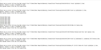

I'm trying to save the report window as PDF and HTML file but it's saving only half of them and during HTML file creation it's showing this error:
"There was an error writing the Web output file V:\User\User Reports\Beverly Jones\Yield Tracking\23Jul2015\Fill Yield (g\AdjAs L).htm.
Reason: Unable to open in ReadWrite mode.
The system cannot find the file specified."
Log Snapshot:

There are 12 iterations in total but it's saving the result of 6 only and interesting thing is that "obj" window is popping up for all of 12 iterations.
I'm not sure why exactly it's happening as the error above looks ambiguous as 6 iterations getting saved properly.
Any suggestion would be appreciated. Thanks!!

Finally I figured it out.
When I was saving the file with parameter name(col2 in above script) for which charts being generated it has "/" in the name and JMP was considering it as path as well which never exists. So giving me this error.
Sorry for wasting time, so dumb of me.
**Remark if name has any \backslashes\ or /forwardslashes/ try to substitute them otherwise this error going to pop-up.
