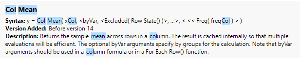

If you are just trying to get mean values based on groups in a script, you will have to use other methods (Summarize for example).

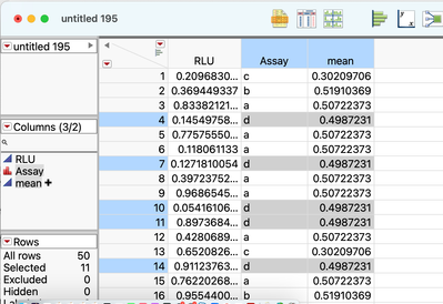

There must be something else going on, as your syntax for Col Mean is OK. For example, the following script works:
Names Default To Here(1);
dt = as table(J(50, 1, randomuniform()), << column names ({"RLU"}) );
dt << new column ("Assay", character, << set values ( words("abcd", "")[J(50, 1, randominteger(1,4))]));
dt << new column ("mean", formula(colmean(:RLU, :Assay)));
You can see that it is computing group means.

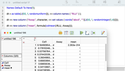

When I first ran my code, I forgot to place the column name RLU in curly braces, so the column name was not created properly, and I got an error like the one you described. Perhaps it has something to do with this?
