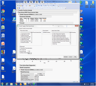

I am still having trouble building a transfer function.  I am using "Sales" as the output and "Inventory" as the input.  I don't have any missing values (represented by a dot in the data table) in my inventory column.  I build both functions and input as below:
Which produced the following error.
Any ideas?

If you delete the rows that have missing Sales and Inventory values (the ones that are hidden/excluded already), that will avoid the error message and fit the model.

That worked!  Thank you!
Re: I am trying to build a Transfer Function
I've run into this before. You have some excluded rows with missing values. For some reason, you have to DELETE those rows. Then you should be able to build the transfer function.
