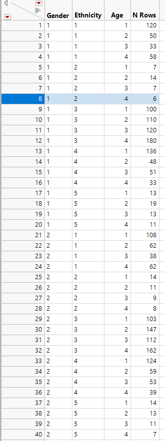

My JSL completes successfully if the potential pool size is reduced to 6.  My code requires that at least 1 sample has to be able to be pulled from each sub group, and since subgroup, 1 2 4   only has 6 observations(rows), the code I wrote to find the best sample size had to be modified to have a pool size of 6.
But regardless of that, I am apparently not understanding how you are determining your pools.  I was equating your pool, to a random sample, with a given sample size, for each subgroup of data.  This turns out to be a false assumption on my part.
Are you creating pools independently for each subgroup?  That is, for subgroup  1 1 1, there are 120 rows of data.  If the pool size is 8, do you create15 pools?  And then for group  1 1 2 which has 50 row, you would create 6 pools, with 4 rows not being selected for a pool?
Is this how you creat your pools?
Here is the break down of all of the Gender/ethnicity/age subgroups.
My current JSL does not do what you want,   Please give me a more precise explanation of how to create pools, and I will see what needs to be done to put together a workable script.
Jim

Hi Jim,
The subgroups are created by having ~ 8 individuals in each pool. You are correct regarding 1-1-1. This group has 120 individuals, so if we were to pool these individuals randomly they should fit into exactly 15 pools. For group 1-1-2, which has 50 rows, you would create 6 pools of 8 individuals and the remaining 4 would be put into their own pool.
Does that make sense? We want all rows in the data table to be associated with a specific pool number.
M. Dereviankin
