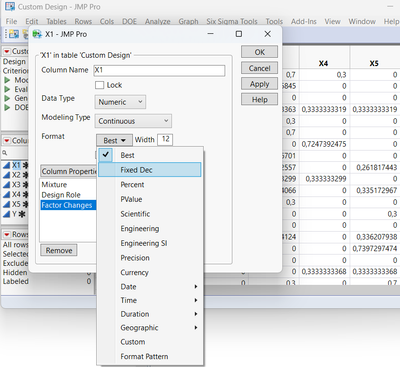

I wonder why JMP introduces the four highlighted numbers (yellow) in the design (0.025064, 0.024936, 0.025089 and 0.024911)? Why are these four values not 0.025?

The Custom design platform uses the Coordinate-Exchange Algorithm to create designs based on random points, and then move the coordinates of these random points to improve the design based on defined optimality criterion and converge to a specific design.

The "stange" and very precise values you see are a result of this algorithm computation.
When you make your datatable, you can always change the format of the column and limit the number of decimals (double-click on the factors column, click on Format and set the "Fixed Dec" to the number of decimals you want) :
Hope this response answers your question,
