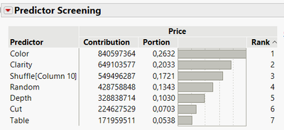

Predictor Screening is a method based on the Random Forest algorithm that help you identify important variables (identified by the calculation of features importance) for your response(s) in your historical data. Depending on the representativeness of your data, coverage of the experimental space, missing values, presence of outliers, interactions, correlations or multicollinearity between your factors, this platform may have some shortcuts, many unknowns, and shouldn't be trust blindly.

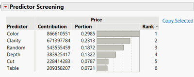

  • Since all factors are ranked, the threshold/limit between important and non-important factors is not trivial. To help you with, you can add a random factor (with random values). An example of this technique is shown here with the Diamonds Dataset from JMP with Price as response, adding a random factor and omitting Carat Weight as possible input (since it is a very important predictor, so I wanted to show you an example where it's hard to sort out the other predictors) :

  • High cardinality categorical factors may also bias the feature importance calculations. The more cardinality (number of classes), the higher the bias, as the data will form a high number of small groups/classes that the model will try to learn. So it will fail to generalize or "understand the logic" and as a result this will increase the chance of overfitting, giving this feature a high importance.
    An example here with the same dataset, same conditions but adding a random categorical factors with 11 levels (from A to K, named "Shuffle[Column10]). This categorical random feature with high cardinality is ranked higher than the random numerical variable seen before :
