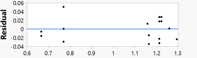

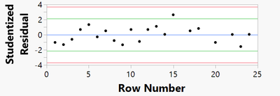

To answer your questions:
Here are the residual plots for parameter A:
No conditions were fully controls technically. Previous DoEs were performed with ~45% starting material, the closest in this RSM was 55%.
