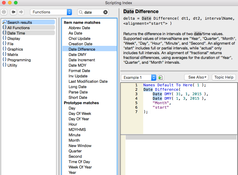

Try 'Help > Scripting Index', then enter 'date' into the serach field to produce:
This shows the JSL primitives that match your serach, and, typically, there are one or mode examples of each to get you going.

Thanks for the help. I'm using an older version of JMP so it doesn't have  any other examples. Do you have any idea how I would use the function for timings?
