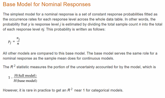

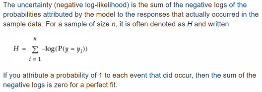

From the JMP help on nominal logistic regression:
This looks like the McFadden type, as your referenced article claims that JMP uses. I did not see anything in the JMP documentation claiming that all of the different RSquare types are the same.

Well, my question is composed of two: regarding the R2 for nominal response and Generalized R2. The response about R2 I have just got from you. Many thanks!
As for Generalised R2, the documentation states the identical character of the R2 types. Link + the page attached. So, I ask you kindly to check them and clarify me the case of Generalized R2, if you would not mind.
