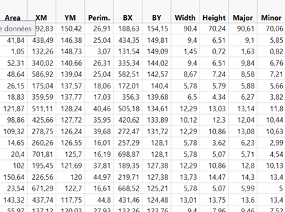

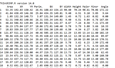

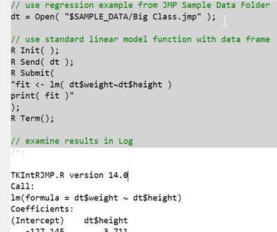

Your example works I had this in the log :

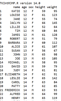

For your second question I'm not sure I'm understanding it well. But I try to send my JMP data table to R with send() command and then print it in the log. For your example it looks like this :
In my example i got this in the log :
and my table look like this :
