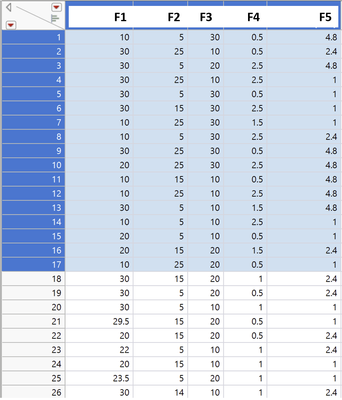

I have a guess why it fits model on this restricted factor levels and responses. When I did Augment Design, I restricted the range of the factor levels to augment. For instance, I have F1-F17 highlighted with blue (designed by DSD) and F18-26 (designed by Augment Design) below.

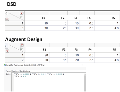

As you can see below the range of F1, F2, and F3 changes from DSD to Augment design. I have also used Disallowed combination tool to limit the range of F4 and F5 to where I want.
It seems like, though, this restriction is still applied when I try to build the model. Therefore, I am only fitting the model with "restricted" levels of factors. It seems like I need to unlock this restriction to be able to fit the model on the entire dataset. @Mark_Bailey Do you know how to solve this issue by chance?
