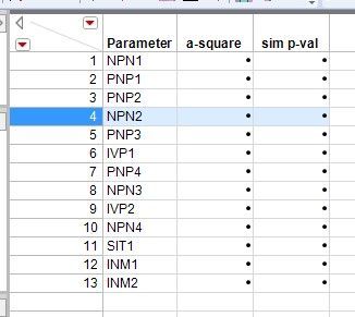

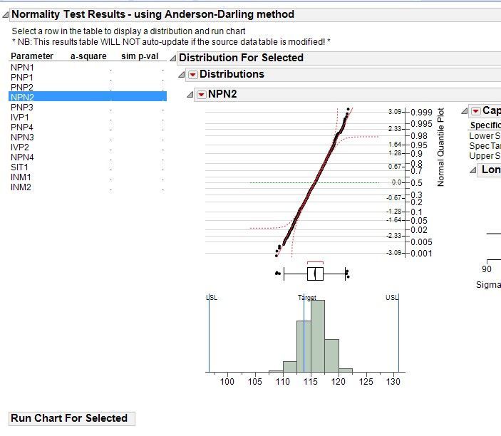

@SophieCuvillier actually I forgot I had created a non-python version of this script - I only changed because the python version was much faster for large data volumes.
Please see attached, I hope it helps. Note that everything below line 107 is just for creating the results display window - if all you want is the table of comparative p-values, feel free to delete that code.
I only have JMP 18 to try it with, but it should be OK with v17.

I don't know why, but unfortunately I don't see the results of the normality test, no output, maybe my JMP version is too low (V14.3). I will try to use a higher version.
Can you make it into a jmpaddin file, so that it can be used better.
I hope to only see the results of the normality test, without the need for capability analysis.

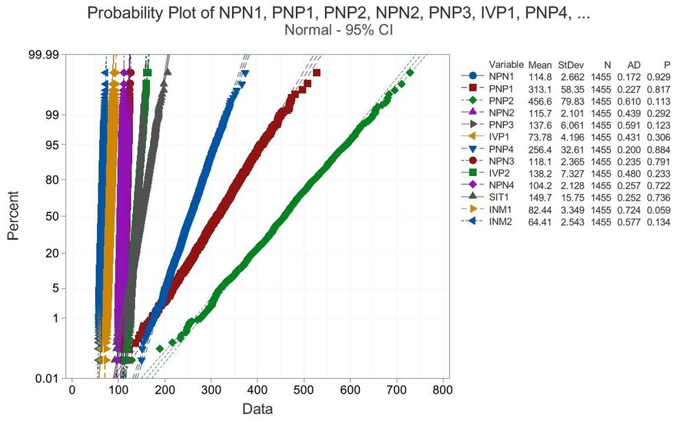

This picture is the result of MINITAB. Can you make it look like this?

You can create the normal quantile plot comparing multiple parameters by stacking the data and using the Fit X by Y platform. For example, see the simple code below:
View more...
dt = open( "$SAMPLE_DATA/Semiconductor Capability.jmp" );
dt_stack = dt << Stack(
	columns( :PNP1, :PNP2, :NPN2, :PNP3 ),
	"Non-stacked columns"n( Keep( :lot_id, :wafer, :Wafer ID in lot ID, :SITE ) ),
	Output Table( "Stack" )
dt_stack << Color or Mark by Column(
	:Label,
	Color Theme( "JMP Default" ),
	Marker( 0 )
ow = dt_stack << Oneway(
	Y( :Data ),
	X( :Label ),
	All Graphs( 0 ),
	Line of Fit( 1 ),
	Plot Quantile by Actual( 1 )
You could then build a custom window and include the A-D results table from the previous script as a report next to the normal quantile plot. If you're happy with scripting then this might help:
https://www.jmp.com/support/help/en/18.1/#page/jmp/construct-display-boxes-for-new-windows.shtml
