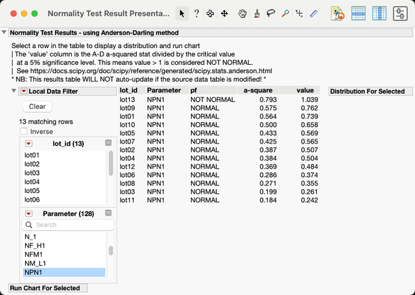

This script tests multiple data columns for normality using the Anderson-Darling method. Each column can be split into groups by a categorical column and each group tested individually if required.
The output is an interactive report ranked by the A-squared statistic as a ratio of the critical value at a 5% confidence level (so data with different population sizes can be compared directly).
The work is done using the scipy python library and requires JMP 18+.

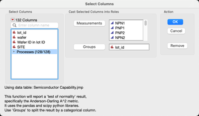

When you run the script it will ask you to choose the data columns you wish to calculate normality for, and optionally a further grouping column (I'm using the Semiconductor Capability sample data set):

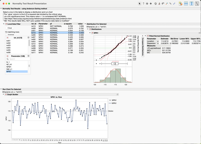

The output is an interactive report ordered from most non-normal to most normal. If you specify a grouping column, it defaults to showing one data column using a local data filter. If there's no grouping column, the filter is removed.
Select a row to show a run chart and distribution report for that subset of the data.

The Semiconductor Capability dataset isn't the best for demo purposes as none of the data is especially non-normal, but it shows the idea.
