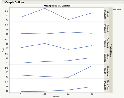

Looking for a way to build the graph below, but broken out by category, and save the script so it can be easily replicated each month.
It is simply a line graph, value vs. month by category. However I am looking for a separate graph for Category A, then B, then C and so on. Able to be produced in one script.
Is there a way to quick produce a single graph for each category through a script?
1 REPLY 1
Jeff_Perkinson
Re: Quick Multiple Line Graphs by category
What if you put your category variable into the Group Y role instead of Overlay?
That would give you something like this:

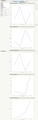

Alternatively, you could put category into the Page role and get graphs like these:
