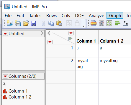

\!r is the escape character that parses to a carriage return. Given the embedded carriage return in the below data table
The following JSL recognizes and removes it

dt << Recode Column(
	dt:Column 1,
	{Map Value( _rcOrig, {"myval\!rbig", "myvalbig"}, Unmatched( _rcNow ) )},
	Update Properties( 1 ),
	Target Column( col1 )
dt << End Data Update;
