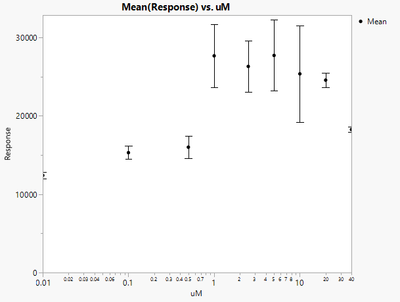

I can get the error bars using Graph Builder.

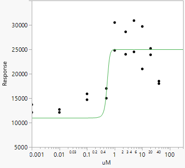

The problem is with visualization: I'm trying to overlay the error bars onto the fitted curve, as can be done using Prism.
I've tried artificially adding a "Column 3" to group my measurements, but I can't "group" 2 measures when using Logistic 4P (or 3P).
Is there a way to do the same in JMP (JMP16)?

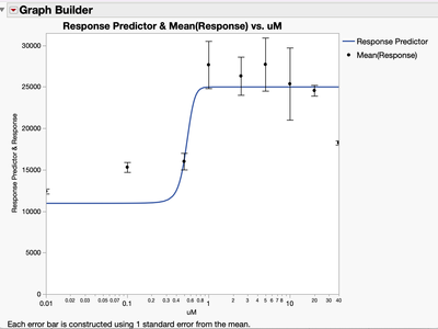

Take a look at the attached table with two more saved scripts. The first involves saving the prediction formula from Fit Curve, then using the Formula element in Graph Builder. The second just uses a graphics script that is copied from the Fit Curve report window (right click on the white graphics region and select 'Customize . . . ' to see all the scripts associated with the graph box). Running the first new saved script should give:
