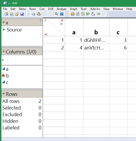

Here's a quick test using open(...csv)
x = "1," || Encode64 Blob( Char To Blob( Repeat( "the quick brown fox", 30000 ) ) ) || ",3"; Show( Length( x ) );
y = "4," || Encode64 Blob( Char To Blob( Repeat( "jumps over the lazy", 30000 ) ) ) || ",6"; Show( Length( y ) );
file = Save Text File( "$temp/x.csv", "a,b,c\!n" || x || "\!n" || y );
dt = Open( file );
Show(
	JMP Version(),
	Length( dt:b[1] ),
	Length( dt:b[2] ),
	Blob Peek( Decode64 Blob( dt:b[1] ), 0, 38 ),
	Blob Peek( Decode64 Blob( dt:b[2] ), 0, 38 )
Length(x) = 760004;
Length(y) = 760004;
JMP Version() = "17.2.0";
Length(dt::b[1]) = 760000;
Length(dt::b[2]) = 760000;
Blob Peek(Decode64 Blob(dt::b[1]), 0, 38) = Char To Blob( "the quick brown foxthe quick brown fox", "ascii~hex" );
Blob Peek(Decode64 Blob(dt::b[2]), 0, 38) = Char To Blob( "jumps over the lazyjumps over the lazy", "ascii~hex" );
(a lot of) base 64 data in middle column(a lot of) base 64 data in middle column

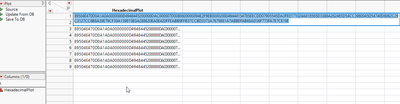

I am quering from the Database server into JMP.
I tried to convert it into Hexadecimal, yet it only reads up to 255 characters
Query:
ODBC = Create Database Connection( "DSN=xxx;" );
SQL= Eval Insert(
   "SELECT hex(plot) AS HexadecimalPlot
FROM db.main.plot_table;");
dt_diesort2 = Execute SQL( ODBC, SQL, "Pic_table" );
Here is what I end up with:
JMP reads limits til 255 char
"89504E470D0A1A0A0000000D4948445200000DAC000007D0080600000094E2F9EB0000200049444154785EECDD07905545DA3FE0171024A818565D3388A262465D54CC3960045D54740D8062C29C3127CC8B8A39E79CF39A139815B3A288620EA0E420FFEABB9FFB37CCBD3373A7679881A7ABBEFAB68AD36F773FA7E7CE19E"
I have attached the original hex values that I want to query in the jmp table.
