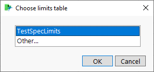

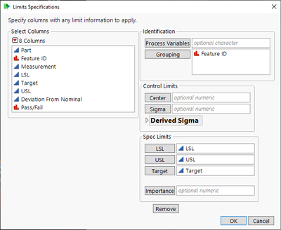

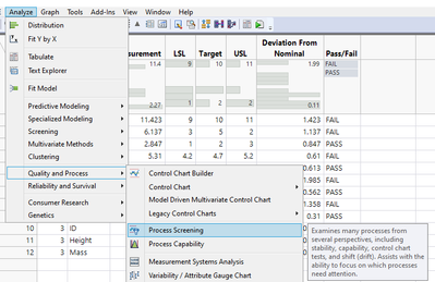

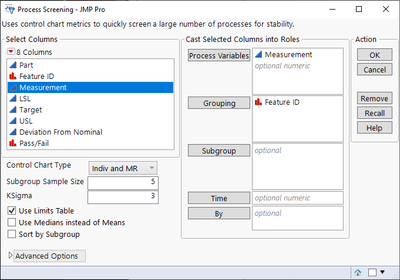

One platform you can use when you have this type of data is Process Screening and you are able to calculate capability values.
If you don't have separate spec limit table you can use same table
