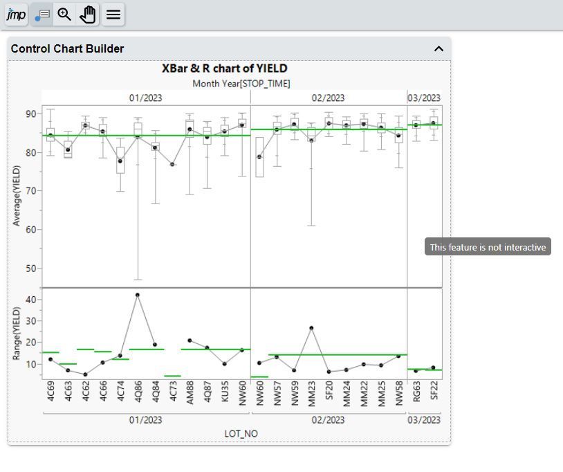

I sort the data by STOP_TIME

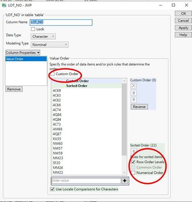

Then change LOT_NO value order to ROW order Levels and draw charts
Then draw control chart and save to interactive HTML, but it becomes not interactive!
Could you help to check this issue? attach file is data table and chart. Thank you.

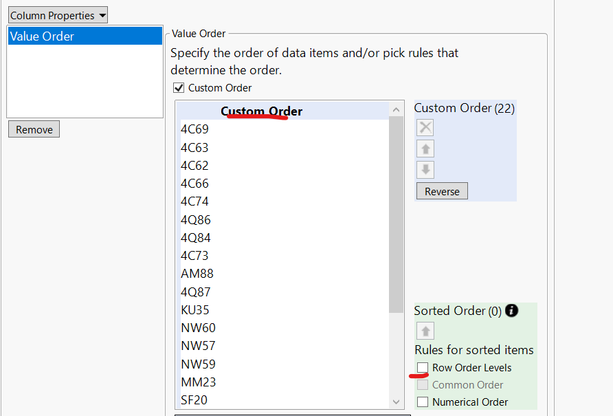

Hi @Chily
It seems that the row order levels property is not supported in interactive html. You can see a log message (View > Log).
If you uncheck 'Row Order Levels' and then set 'Custom Order', you can save as interactive html.
