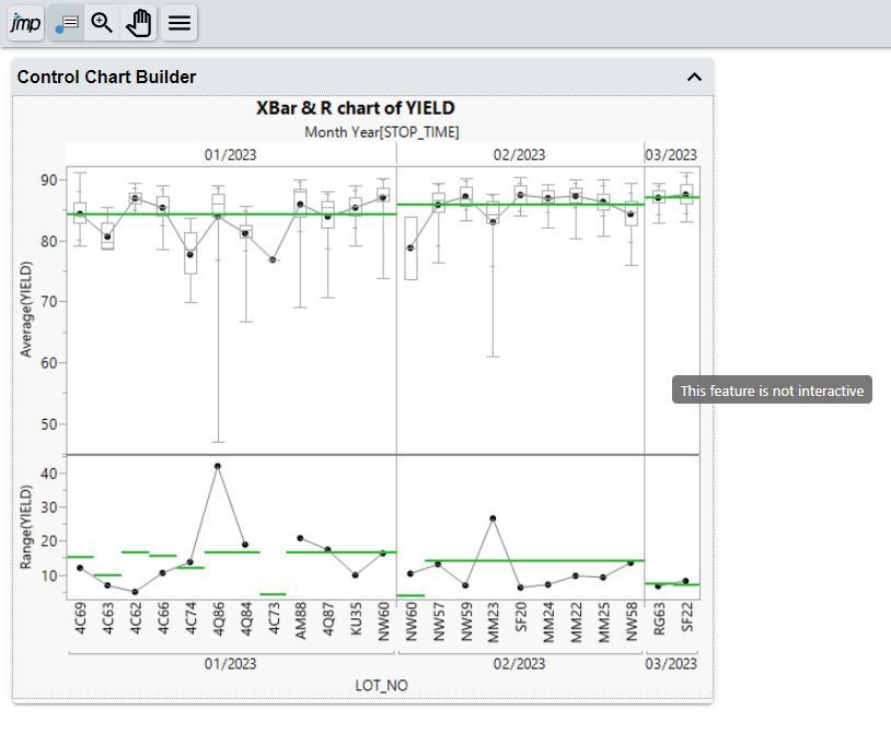

Hi
I have one question and it seems to be a bug, any solution?
I sort the data by STOP_TIME
Then change LOT_NO value order to ROW order Levels and draw charts
Then draw control chart and save to interactive HTML, but it becomes not interactive!
Could you help to check this issue? attach file is data table and chart. Thank you.
Regards, Chily

Hi @Chily
It seems that the row order levels property is not supported in interactive html. You can see a log message (View > Log).
If you uncheck 'Row Order Levels' and then set 'Custom Order', you can save as interactive html.

Hi all - i can confirm that the Row Order Levels option will be supported in the interactive HTML output in the next major release of JMP. (JMP 18, due to be released in spring of 2024). This means that the report will remain interactive after you have exported it to the web. You can see this in action now if you have access to the Early Adopter program.
