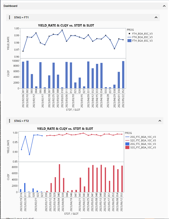

You're welcome, Chily.
We're working on removing the restriction of only one local data filter supported in Interactive HTML for JMP Version 18.0.
The Page role doesn't have control over the rows displayed in an axis on a particular page, but there is another solution that doesn't use two local data filters that should work the way you want.
What you really need to skip those empty slots is to exclude the rows similar to the way the local data filter does. Another way to do this is to subset the data by STAG and build the dashboard with the two subset graphs. This is unfortunately a bit more involved than using the Page role.
In JMP's User Interface ...
Table > Subset ...
... or with JSL :
// Subset data table
Data Table( "data" ) << Subset(
By( :STAG ),
All rows,
Selected columns only( 0 ),
columns(
:DETP, :CLOT, :SLOT, :PKGT, :LAGC, :PROC, :PROG, :LBID, :STDT,
:"Month Year[STDT]"n, :CLDT, :RQTY, :CLQY, :FAIL_RATE, :FSQY, :FLAG,
:HOLD_DATE, :YIELD_RATE, :PK_SITE, :INDT, :HDLR, :HDLT, :PLFM, :LOT_TYPE
The script you would run on each subset table would be the following, which is the same as above without the Page role:
Graph Builder(
Size( 627, 804 ),
Show Control Panel( 0 ),
Variables(
X( :STDT ),
X( :SLOT, Position( 1 ) ),
Y( :YIELD_RATE ),
Y( :CLQY ),
Overlay( :PROG )
Elements(
Position( 1, 1 ),
Points( X( 1 ), X( 2 ), Y, Legend( 9 ) ),
Line( X( 1 ), X( 2 ), Y, Legend( 10 ) )
Elements( Position( 1, 2 ), Bar( X( 1 ), X( 2 ), Y, Legend( 14 ) ) )
If you combine these graphs in a dashboard, you can rename Graph Builder to STAG = FT1 in the top graph and STAG = FT2 in the bottom graph. The resulting dashboard would be:
