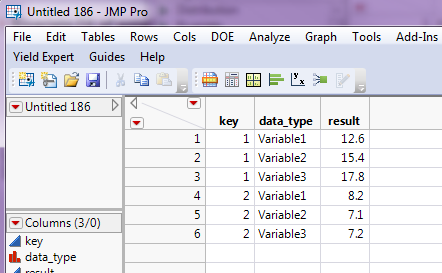

My SQL database has the columns like this:
keydata_typeresult
1Variable112.6
1Variable215.4
1Variable317.8
2Variable18.2
2Variable27.1
2Variable37.2

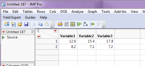

I would like a query to bring in the data to jmp like this:
jmptable:
keyVariable1variable2variable3
112.615.417.8
28.27.17.2

All you need to do, is after you have initially read in your table from your SQlite database is to then Split the data into a new table
     Tables==>Split
Specify data_type as the Split By value
Specify Result as the Split Columns
Jim

Great this works, thanks!
