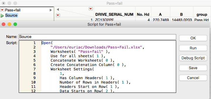

ian_jmp
Level X
Re: Properties of columns in a script
Pardon me if I have misunderstood what you are asking. But if you open an Excel file in JMP, the resulting table should have a 'Source' script that you can work with:

ian_jmp
Level X

I think Ian has a better answer: Use the interactive Excel import on the new table. Then edit the source script in the imported table. That source script will be similar to the script you posted.
I may still be misunderstanding the question, so if this doesn't make sense, please ask again.

Françoise
Level VI
when I open the source script, Ihave only this:
Open(
"S:Pilotage\BDD New\BDD Vincent.xlsx",
Worksheets( "Qry_Cuve" ),
Use for all sheets( 1 ),
Concatenate Worksheets( 0 ),
Create Concatenation Column( 0 ),
Worksheet Settings(
1,
Has Column Headers( 1 ),
Number of Rows in Headers( 1 ),
Headers Start on Row( 1 ),
Data Starts on Row( 2 ),
Data Starts on Column( 1 ),
Data Ends on Row( 0 ),
Data Ends on Column( 0 ),
Replicated Spanned Rows( 1 ),
Replicated Spanned Headers( 0 ),
Suppress Hidden Rows( 1 ),
Suppress Hidden Columns( 1 ),
Suppress Empty Columns( 1 ),
Treat as Hierarchy( 0 ),
Multiple Series Stack( 0 ),
Import Cell Colors( 0 ),
Limit Column Detect( 1 ),
Column Separator String( "-" )
But without the informations about the status of the columns( numeric, ordinal, continuous,..).
