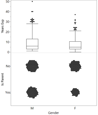

Starting with the consumer preferences data set, I can make a graph like this with customized y axis labels.  For example I customized "years at current employer" to read "Years Exp"

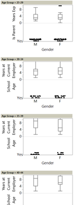

 Then if i add "age group" in the page field
You'll notice that the custom axes are not kept for the later pages.

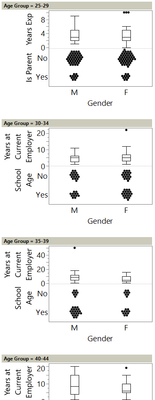

If I try copying axes properties and broadcasting with ctrl+paste axes properties, it broadcasts properties from a single y axis to all graphs and y axes, which causes a problem because "years exp" has a different range than "is parent"
Is there a good way in graph builder or JSL to broadcast the customized axes properties when dealing with multiple stacked y axes, for example?

This script illustrates one approach:
Names Default to Here( 1 );
// open example
dt = Open( "$SAMPLE_DATA/Consumer Preferences.jmp" );
// launch graph builder with multiple pages
gb = dt << Graph Builder(
	Size( 528, 3450 ),
	Show Control Panel( 0 ),
	Variables( X( :Gender ), Y( :Years at Current Employer ), Page( :Age Group ) ),
	Elements( Box Plot( X, Y, Legend( 4 ) ) )
// access report layer
rpt = gb << Report;
// find all text edit boxes
axis = rpt << XPath( "//TextEditBox" );
n = N Items( axis );
// change text in all text edit boxes of vertical axes
axis[4::n::2] << Set Text( "Years Exp" );
